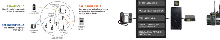

I've put links in from Teldio and Zetron. Most people didn't care for it after trying it for a few weeks.

Motorola's Digital Phone patch works pretty well with an XPR7550. You do need to run it on a DMR repeater (SLR5700 or better) and purchase an EID entitlement for about $500, and then you also need an old analog phone patch like a Zetron model 30 or similar.
Yeah, it's push to talk simplex telephone (key the radio to talk, release to allow the other side a chance to reply) - which takes a little getting used to, but it is clear and effective, and it can be a reasonable alternative for wide area coverage.
