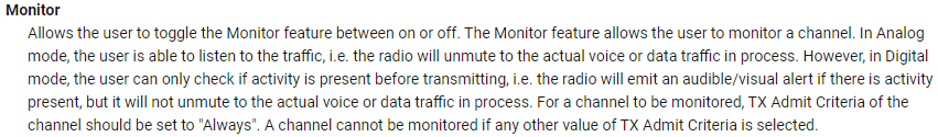

I'm not sure why they designed it like that. Here's the only mention of it that I've found in the Help file:
As for your Zone issue, K2NEC has the solution in post #2.
