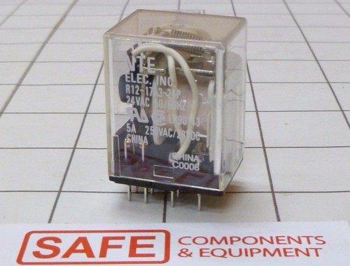

found the newer version of relays
and also none of my lights come on when i use my control box

It sounds like you have an issue with the the control box...Those lights should come on as soon as you plug it in and turned on.. I bought my control boxes on ebay. Check around ebay ,craigslist, Marketplace.. Those are easier to find... Those relays your showing are probably for those older type boxes.. I am no tech by any means.. I would have to find someone to install... Here in CT. there is nobody to even work on radios.. Good luck searching for control box.. Let me know if you find one.. Don't spend alot of money on it ... I have 3 boxes but1 has a light out on it... The relay boxes are a hard find... Goood luck and Merry Christmas... thanks ,Mike

i took the box apart and found all 3 bulbs to be blown replaced them and all seems fine on the controller end.i may take a chance and order 2 relays and see how it goes .Merry Christmas to you and yours happy holidays
