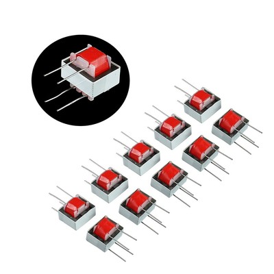

As far as the MTS2k, I second Batlabs as a resource. Pins 2 and 6 are what you're looking for on the accessory connector, but the suggestion to use an old speaker mike is even better; just disconnect the speaker and connect an isolation transformer in it's place, feed the other side of the isolation transformer to your feed appliance and you're all set.

Interesting. I have ordered some some stereo isolation transformers already. Will I have any bleed over issues if I use isolator with two radios? Each feed is going to a separate feed applicance and a different channel of the isolator?
You can certainly try it, but I wouldn't recommend it; you're talking about an inductive device, and while it would probably work fine the chances of cross-talk due to coupling are always there. With a stereo you could get away with some slight cross-talk since there's almost always something happening on both channels at the same time and it wouldn't be noticeable, but with radios Murphy says that one of them is almost always silent while the other is babbling so it would be more noticeable if it happens.
Isolation transformers are cheap so I never worried too much about it; the last bag of ten I bought cost less than ten bucks on eBay. Solder the appropriate connector cables on to either end and seal it up in a big hunk of heat-shrink tubing (I use plastic film cans myself) and you're off to the races:
I thought that would be the case. I hadn't thought of making my own.
