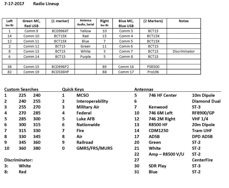

I keep track of the stuff with a cheat sheet that looks like this:

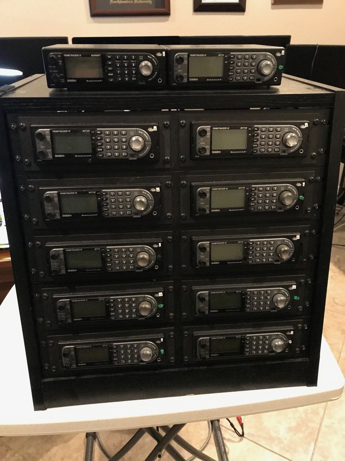

Here is the front of the rack showing the 12 radios 7 BCT15, 4 BCT15X, 1 BCD996XT). 10 radios are in the racks and 2 on top.

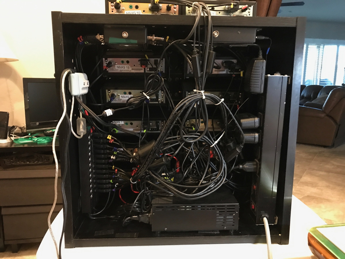

Next is the overall rear shot showing the rats nest.

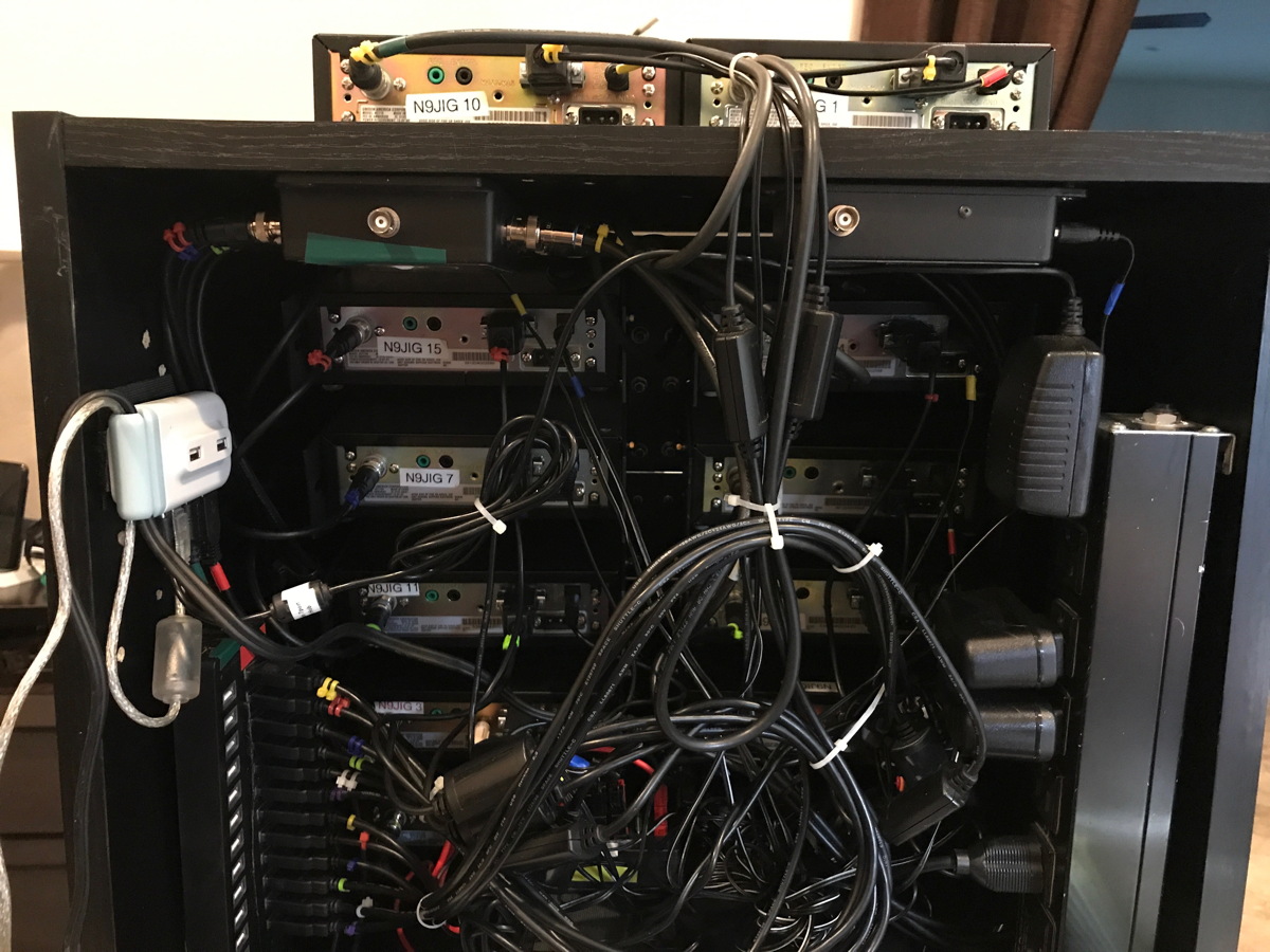

Here is a closer up view of the upper section. Notice the various color wire tags. One side has 2 tags and the other just one each. This allows me to tell which radio is connected to each cable. Each radio row has a color, each column has either 1 or 2 tags.
You can also see the little 4-port USB hub in which the 2 13-port ones connect into. This is a hold over from when I used the same case with a couple SDR sticks. I might delete this hub and just plug one of the 13's into the other but it has been working fine and allows me some flexibility for future expansion.
At the top of the case are 2 Stridsberg multicouplers. One is an 8-port, the other 4. This covers the 12 radios nicely.
Here is a closer up view of the lower section with the power supply, outlet strip and USB hubs. The rear 13-port hub is for the USB-Serial cables and the front one will be used for the sound cards when I decide on a solution for that. I already have the sound cards and cabling done but I am still trying to find an ideal solution for handling the audio. Currently I am just using the radio speakers which is fine for listening in the office. I would like eventually to be able to record the audio and maybe even make it available remotely.
