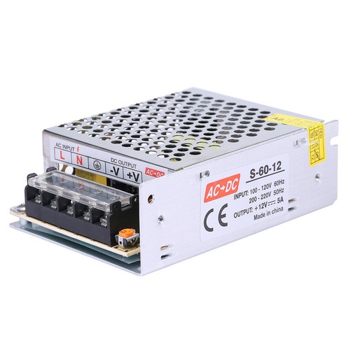

Since you are only going to use it for receiving, this may do the trick ($7.89) as far as cost is concerned:
Since they’re for strip lights, who knows how well they are filtered?
How do we know how well anything is filtered that isn't over $50?
I have a 12v wall wart that I got for $3 at a garage sale that really seems to have some decent filtering, and I use it all the time for a receiver.
For a few bucks it was worth a try and it worked out better than I imagined. Just because it's cheap does not necessarily mean the worst, especially if you have no first hand experience with it. Experimentation is part of the radio hobby and we can't be afraid of making mistakes or making a decision based on optimism.

It would require you to use that white adapter from the round plug to the bare leads of the radio power cable! Very hard to tell from the Amazon pic but I really doubt the wires are going to fit in that adapter! While you’ll only be receiving the wires are a fairly large gauge to handle transmit amperage..,
24,196
I am a lineman for the county.
On paper it should work. The LED strip adapter might work fine for connecting to the power leads on the radio, but it might be too small for the wires to fit inside.
"On paper it should work" means that the specifications match what your radio will do in RECEIVE ONLY. What we can't tell is how noisy the power supply is. Some of these cheap switching mode power supplies can cause a lot of RF interference. Having that interference source connected directly to the radio is going to be a pain to resolve.
Buyer beware.

Quite honestly I would not trust such a wimpy power supply. Invest in a proper power supply now and be prepared for future needs.
