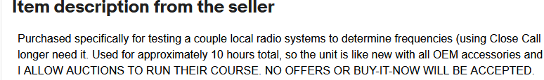

The link you posted does not have a "Buy it now" option. Seller states:
I have no idea whether the description given is accurate, though apparently the seller has positive feedback. The downside, of buying one from eBay, is that there is no warranty. This seller also does not accept returns. While this is not tagged as "refurbished", the downside of refurbished, from one of the better known dealers, or Uniden, is that there is normally no more than a 90 day warranty. A brand new unit has a one year warranty. Note that Uniden limits warranty coverage to the original purchaser, and requires a copy of that original retail receipt for warranty repairs. So even if the unit is 'brand new', or only a couple months since original purchase, the warranty is not transferable.
There are several other auctions, for the same model, linked on the page, but I'm not going to speculate on how accurate any of them are. If you roll the dice & proceed with a purchase on eBay, I hope it turns out well for you. I have not personally purchased from any of the currently listed sellers.

If the description that @hiegtx posted is truthfull.... I would think it's never been registered with Uniden...
Database updates and firmware updates are done with the Sentinel software... Free to download from Uniden...
Scanner does not need to be registered for that...
To purchase the upgrade keys thru Uniden the scanner needs to be registered with them...
But as said above you will have no warranty...

Registering the scanner on the "My Uniden" site is not cross-referenced by Uniden. Even if, for a "previously owned" unit, the original owner did register on My Uniden, that has no impact on you, now, registering it once you obtain the scanner. Note that if the previous owner registered it, and had purchased one, or more, of the upgrades (DMR, NXDN, or Waterfall), those will not pop-up when you register it under your name. So, if purchasing a previously owned scanner, with upgrades installed, ask the seller for his/her proof of purchase for the upgrade, That could be a copy of the confirmation email they received during the registration process, or a "screen shot" of their "My Uniden/My Scanners" page. You need to get, and save, a copy of the key that was issued for the scanner.
Note that if, unknown to you, the original owner purchased an upgrade, while that will not show on your "My Uniden" page, were you to also purchase the upgrade, you would not be able to enter the key generated by the purchase, because the upgrade was already installed. So, ask if an upgrade was done, and if so, ask for the key. It would be a waste of your time, as well as money, to buy a duplicate key that you cannot apply to the scanner.
The listing does not mention whether or not the original purchaser entered it on My Uniden. Even if he (or she) had done so, nothing prevents the new owner from registering it.
The seller on eBay (presumably the original purchaser of the scanner) should have the original purchase receipt, but that is going to reflect his/her name, not yours, if you tried to send it in for a warranty repair. That's regardless of whether they did, or did not, register it on My Uniden as well.
