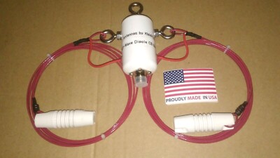

Okay. So I ordered the Dipole antenna above and this cable. Thanks for you help. I will make this work with a little effort and help from you guys.

I didn't realize how much space the dipole needs to be set up until I did a little research.
I would not have enough cable to do it. I'm gonna return it and buy a base antenna. I did spend the extra money on good cable. So I'm still looking for a good antenna that wont break the bank.
