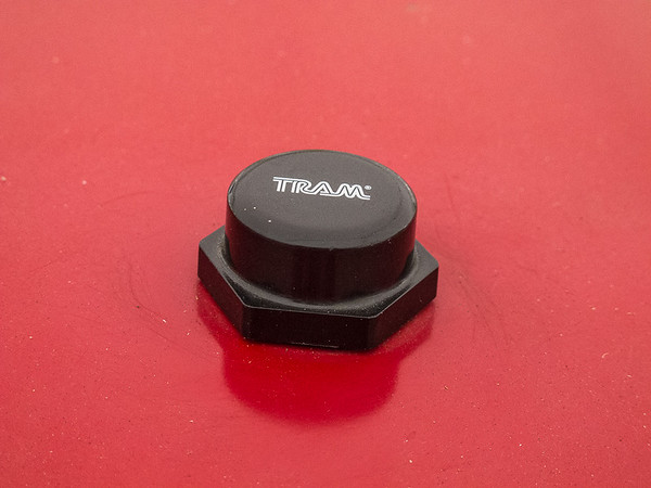

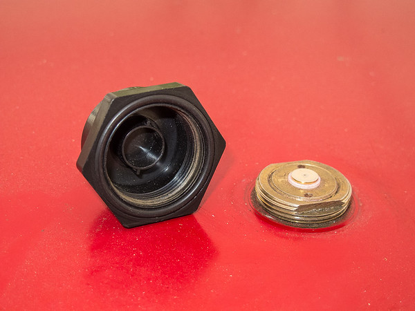

TRAM makes a nice plastic screw-on cap for the NMO mount. I put one of these on when I don't have an antenna installed.

prior to my installing a remote spotlight on the roof, i had several caps. When it went thru the carwash at the oil change place, antennas came off, caps went on, radios were disabled.

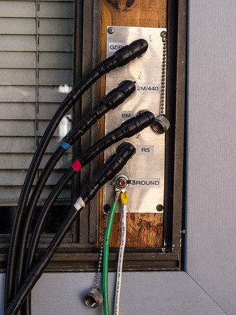

When I built my window feed-thru panel, I used the barrel type UHF connectors. I was able to find screw-on caps that I can put on when the connectors aren't in use. You can see them in the picture below.
While they might not be suitable for use on a UHF vehicle mount, they'd be better than nothing.
