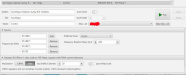

This is what the channel setup should look like in SDRT. You will need 2 sdrs to cover all the available talk channels, as the channel used can change with each transmission.
Then you have to create a Alias List and import the TGIDs, and only set the two Life Guard freqs to listen. You will still receive all the other TGID's and they will show up, but will not be heard or decoded. You can also set up Blacklists to block all the other TGIDs. It's not as simple as adding the 2 TGIDs for the Life Guards.
