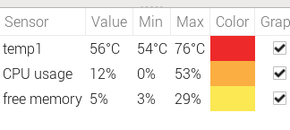

I have an RSPDuo that is driving my SatDump install. On the OP25 setup I'm using a RTL-SDR Blog V3 dongle. I went with the default:
"rate": 1000000,
So that should not be a load, right? Maybe I'll try dropping a little more
Well, plots are not an issue since I can't get them to work on my lash-up.
I also noticed this morning that it seems that when I have the VNC window up I'm using for the headless Pi the temp starts climbing. If I minimize the window the temp goes back down. Since I went with a new install of Raspbian (Bookworm) it is using Wayland for the desktop. I'm wondering if going back to X11 would help?
I've also noticed that sometimes shutting down the OP25 using ctrl-C doesn't work. I end up having to close the terminal window and re-issue the startup.
These are just things that I've noticed since switching back to the Boatbod fork. Not meant to be complaints. Probably just do to something I'm doing wrong since I don't see anyone else mentioning these things. the biggest issue is the over-heating and I will try going back to X11 and see if it makes a difference.

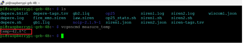

Just to close the loop. I did some more research on the subject and read that faster sd-cards can help. It was recommended to use Sandisk 32GB Extreme cards. I checked the card I was using (Samsung EVO) and it had a read speed of 12Mb/s. The Extreme tested at 27Mb/s. That improved it but I also ordered a new case with a fan and now it is running at 47 deg C. This is sticking with Bookworm. I still get a few Task Queue 1 messages but they clear away quickly. Where as I was getting up to TQ 6 messages on the old card. So you can salvage an old RPi. I may try Boatbod's edit regarding threads for waitress and see if iy gets rid of the Task Queue messages.
