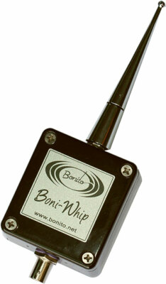

Another possibility - though more expensive - is the Bonito Boni Whip. No doubt that a good Google search will come up with more...I see it's also available on the Amazon UK site.
