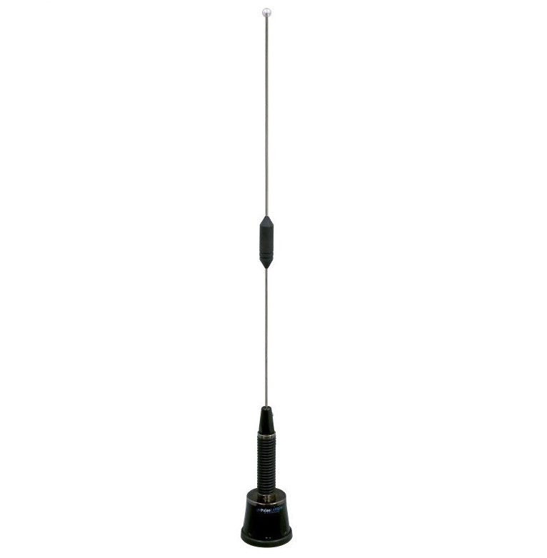

Can you provide the model number of the Larsen you mentioned?
I also have one of those COMPACtennas for multi-band scanner use, but I'm extremely hesitant going through the car wash with it on the roof of my SUV.
24,396
I am a lineman for the county.
I think Antenna Farm sells it, but it doesn't show the SF (SuperFlex) suffix:
Arc Antenna sells it with the SF suffix:
I do have the SF version and it's quite flexible, but not to the Stico levels of flexibility.
