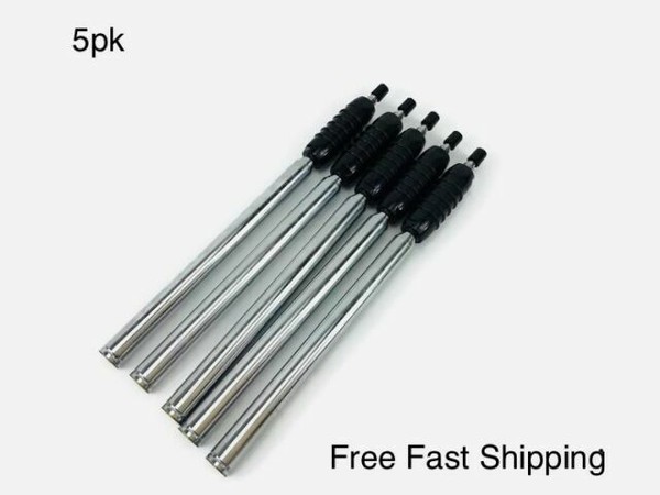

I found some long telescopic antennas such as this:
...but I don't think that will be loaded correctly for TX, am I right?
The best option I can find is this old stock of replacement antennas for those old Realistic portable CB radios:
...but they have no connectors installed. Maybe someone knows the name of those adapters that press fit a BNC into a telescoping ant?
If not, does anyone have any better ideas?

"...but I don't think that will be loaded correctly for TX, am I right?"
Correct.
"...but they have no connectors installed. "
There are no connectors installed because these antennas are mounted to a bracket inside the radio case that is fastened to the circuit board.
Is there an antenna on the unit you are purchasing, if so why not use that antenna? What radio brand and model number are you purchasing?

The unit is the Midland 75-785 and it comes with a tiny rubber duck antenna and I've read complaints about it not going very far (like not more than 1/4 mile). I almost purchased a Realistic TRC-216, but I decided I wanted something new and less expensive instead.
Do you think I can install a BNC on the end of those realistic antennas? Or is there another similar loaded high quality antenna?

You could but, I don't know how well it would perform electrically. Also, I owned a pair of the Radio Shack handhelds, those antenna are very long. If you put a connector on the end of one of those antennas and connect it to the Midland radio's BNC connector it would likely, in a sort time, damage the connector on the radio from the stress caused by the weight and leverage of the antenna.
Not recommended.
