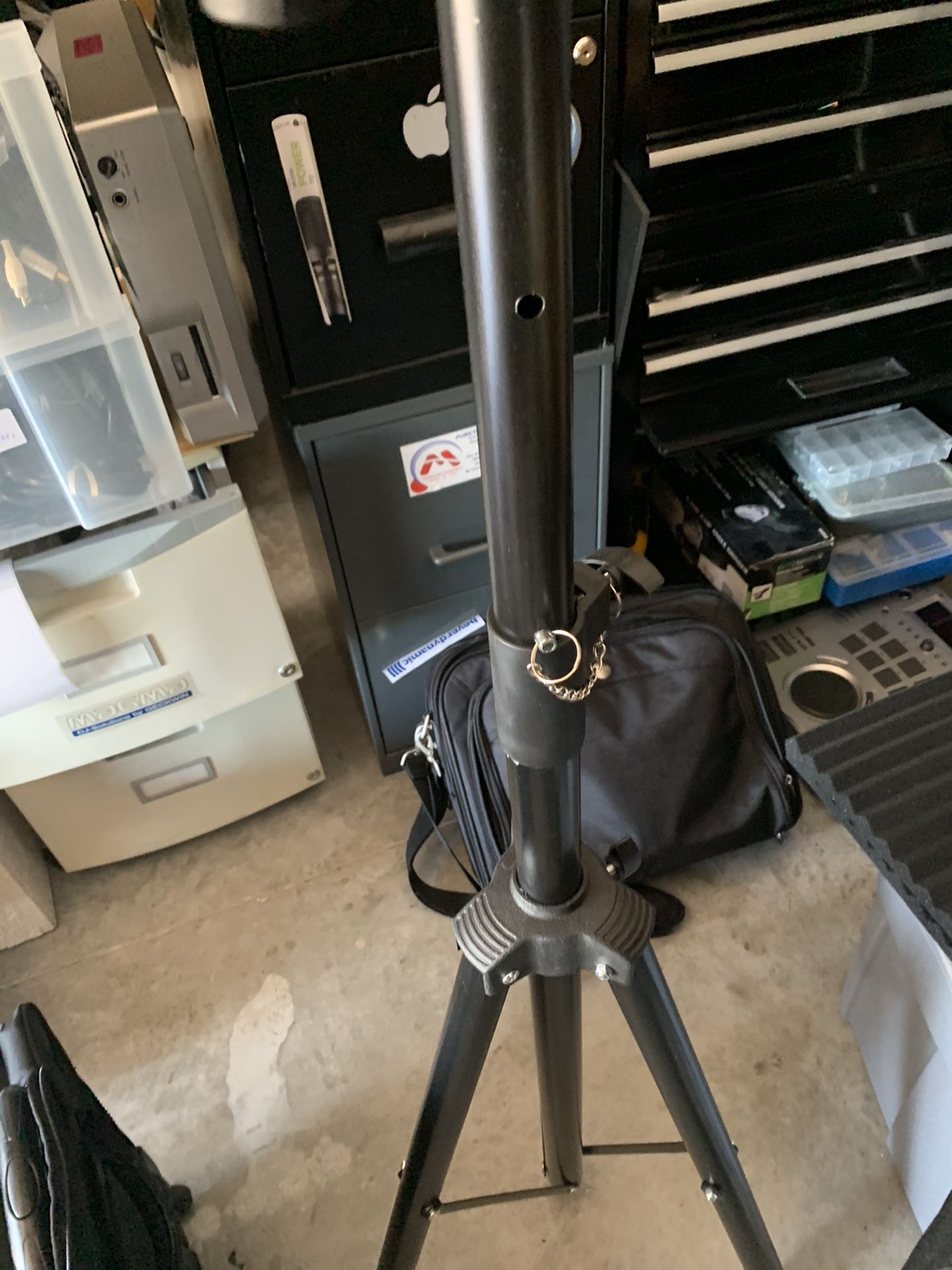

I have one made of PVC very compact and easy to transport. It would not stabilize a large antenna but could be upsized.
