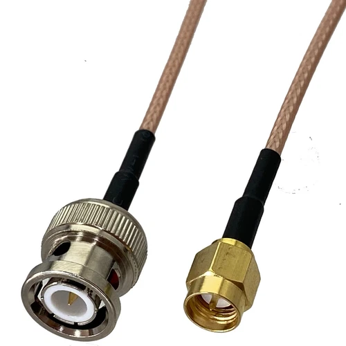

i saw that one but its not BNC so i would be adding loss to remove loss .. i was looking at that moonraker M100

You connect between devices using pigtail coax with the correct connectors at each end, no extra loss. Connectors do not add any loss that you can measure. I do not recommend M100, it's not up to todays standards.
