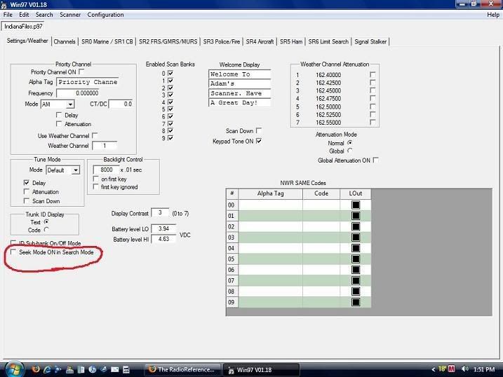

Well, I think I finally figured it out. The problem was in the settings it received from the WIN 97 program....
Unknown to me, the "Seek Mode ON in Search Mode" box was checked. After I unchecked it and resent the new settings to my 97, the problem was gone. WOO-HOO!!! :D :D

AHH! That makes perfect sense! Since I haven't uploaded from Win97 yet, mine must be off by default.
That's pretty cool. I didn't realize that program was so powerful.
