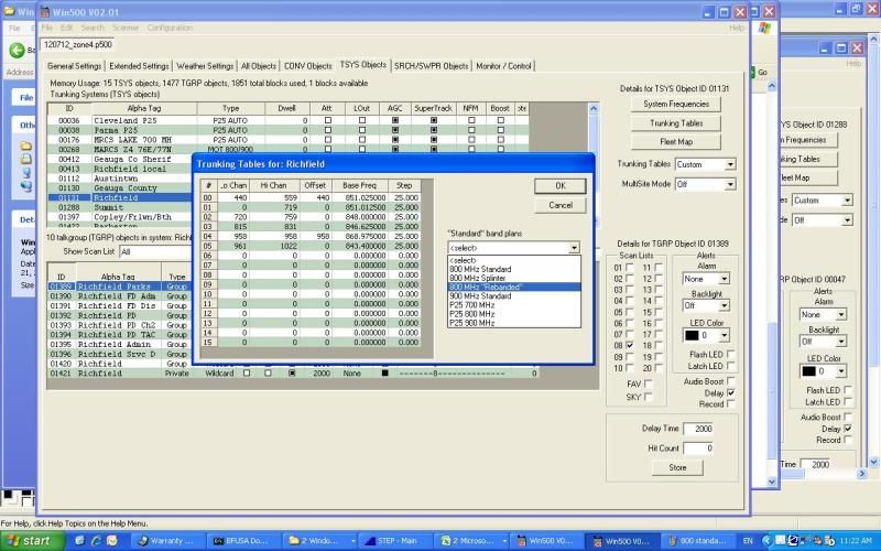

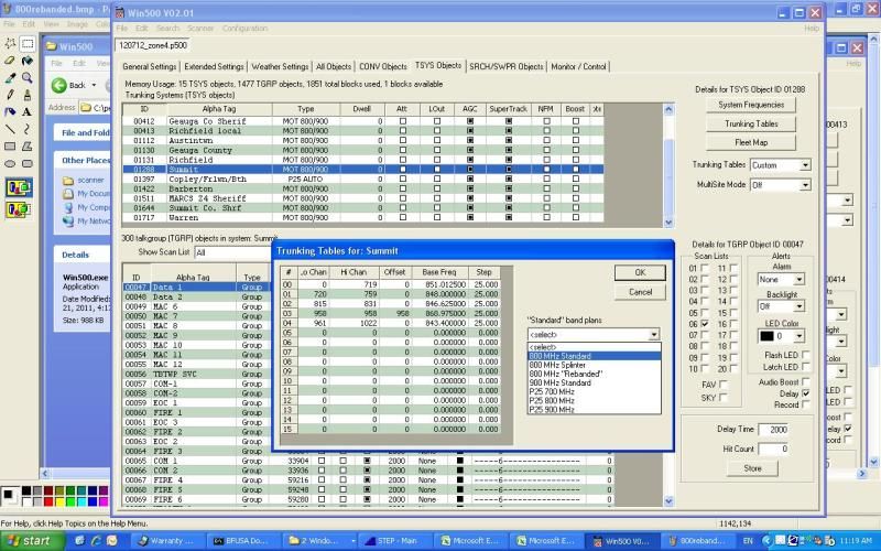

OK... I want to make sure I have this down 100%.
Heres what my screenshot (of WIN500) shows me for 800 MHZ Standard (not re-banded) trunking settings (MOT 800/900).
heres what it shows me for 800 MHZ rebanded trunking settings for a MOT 800/900 system.
Are these the exact same settings you gave me in the above post?
It seems like I noticed some differences (most stuff was the same, just there was a line or two that may be difference).
Any help is appreciated!

No they are not exactly the same, The Standard one is just factory, like you would use if a system is (NonRebanded) still in the 860's mhz and above, or you can use the bottom one that you posted it will work for Rebanded and Non Rebanded it doesnt matter. The difference is this..
Lo Chan, Hi Chan, Offset, Base Freq, Step
0, 439, 0, 851.012500, 25.000
440, 559, 440, 851.025000, 25.000
560, 719, 560, 865.012500, 25.000
The third table is missing on the one you show, but this is because they put 0 LO CH TO 719 HI CH instead of the above so it covers the First Table and the 3rd Table it combines them together, no need for the 3rd line or 1st line in yours because they put the 2nd line first and combined the 1st and 3rd Lines together, but all in all either way will work, from my expierence with My buddies pro 197 and my psr 310 work with the ones I put above on the 8th perfectly fine and really if your system is Rebanded you can just use The First 2...
witch is what I got in my psr 310 now and what my buddy gots in his Pro 197, but before that when Rebanding hadnt happened yet here in Indiana we had the 7 Tables, what I put above a few posts ago, I just removed all but the First 2 because the rest were not needed no more since Rebanding.
You can also put it this way...
0, 719, 0, 851.012500, 25.000
In my expierence it doesnt matter, this is whatever floats your boat kinda thing, there is no wrong or right in this situation unless you put the Standard Table when its rebanded or if you use none of the Tables I posted or the Rebanding Table you posted then it wont work, THEY HAVE GOTTA BE the one you posted above as Rebanded or the 2 I put above in this post, or the 7 table one from a post above from the 8th will work if it is Rebanded. The 7 Table one will work whether rebanded or not and so will your rebanded one you posted above it will work rebanded or not. I think that the 7 Line Table from the 8th that I posted is called a nonconflicting Channel Table if I remember right. All in all its whatever floats your boat:)
What I dont understand with your Tables ( not saying there wrong, because there right and will work just as good as the ones I've posted) is why the Offset is 0 for all but 2 in your above and not going from the Lowest Channel # from the Table for the Offset.
To answer you, its all good you can put the Rebanded Table for both your systems if you want, or for the one that has Rebanded you can use the 2 Table ones from above in this post, but only if it is Rebanded:) Hopefully this will sort it out for you, all in all Your All Good;)
LOVE AND BLESSINGS
