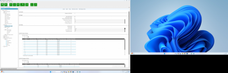

post pictures of the relevant programming screens, we are not there to see what your current settings are.
a417
Mar 14, 2004
4,669
3,529
please.
zoom in to those pictures, and then tell me they are legible.
If you area select, and don't save the image as your full dual monitor desktop wallpaper resolution, you won't have that issue.
