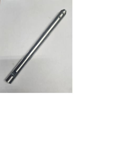

BREEDLOVE MOUNTS
Has an adjustable riser for the quarter wave whip:
102” Whip Adjuster 10”
This single piece with a 5” range-of-adjustment would be superior to the six-seven parts I cobbled together shown early in the thread (given that the antenna mount location isn’t one where a spring is wanted).
I store the whip inside the 8’ pickup bed topper. This piece looks as though handling the whip off the mount would be easier as well (3/4” dia).

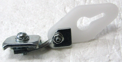

And, let’s not forget the whip clip:
K101X - Kalibur CB Steel Whip Antenna Tie Down​

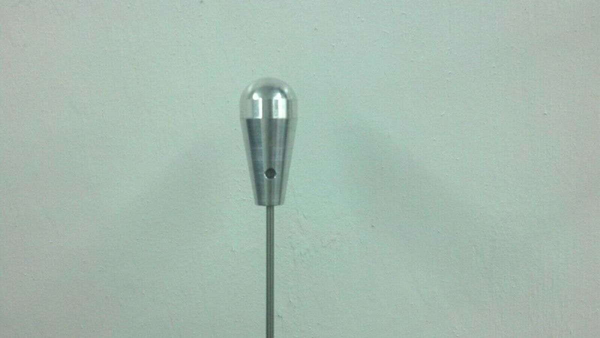

Or a Corona ball to keep the tip from shooting flames:
Several years ago, when I had a 102" whip on one of my cars, I couldn't locate a whip clip. Then again, there wasn't an Amazon and CB shops were literally non- existent without the Internet to search for one.
In a military unit I was in, the stock “whip clips” wore out quickly in certain operational environments. We then used .50 cal links, held in place with a single sheet metal screw and washer, to hold the tip of the whip down. Worked perfectly!
