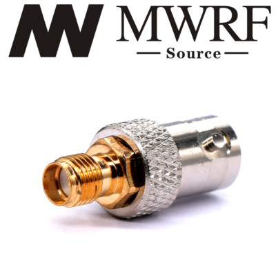

Hmm, let's try this again. The standard SMA will not mate up with the quick connect QMA. They are incompatible.
If you want the top of the APX portable to have a quick connect, you'll need to buy an SMA female to some sort of quick connect type adapter. It really doesn't matter what you have on the other end of that barrel sticking up out of the APX...you can go with a QMA male or female, or you can keep it even simpler and just go from SMA to BNC, which are a dime a dozen.
You seem to be hung up on the QMA, however you should probably just get an SMA female to BNC barrel, then use a pigtail to go from BNC to UHF (SO239). Why bother with QMA when the weakest link in the chain as far as frequency range is the crappy UHF connector?

Let me also point out that the QMA has a mating cycles rating of ~100, whereas the BNC is minimum of 500. If you plan on connecting and disconnecting the APX on a daily basis, the BNC will be more durable in the long run, cheaper to replace annually, and easier to find.
Get one each of these, and call it a day.

I was using this
i was using this:
and than found a bunch of these jumpers in some stuff I had packed away. This will work for me, I’ll order black coax jumper though soon or plastidip this coax cable because pink is just too flashy with black/black interior.
yes APX8k will NOT be left in vehicle unattended. That’s why I was after some sort of QC but this sma will work for me
