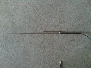

The recommendation to make a J-pole out of twin-lead is about the best idea. I've made several of them for 2M and 220mhz. You can also make one for 440, but the tolerances are a LOT tighter, and it's easier to make one of those out of brazing rod or 10-12ga solid copper stripped out of Romex.
If you have pipe soldering skills, then you can take a try at a "Copper Cactus" which is a J-pole made out of copper water pipe for 2M. I made a J-pole out of brass tubing for 440, and it works spectacularly.

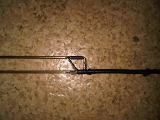

smokeybehr, thanks for your informative reply. I wanted to build the "ears" antenna because it was cheap (very important right now), and Ithought it would be a "fun" and easy project, besides, I love using old technology.
I also just built a twin lead J pole from these plans: The Twinlead J-Pole Antenna. I had my friend do the soldering (she is a professional) and should be picking that up and doing some field testing some time this weekend.
If it works, I might try the 10 or 12 ga stripped romex next. Do you think that would be worthwhile improvement from the twin lead J? Thanks again.

I seriously doubt if there will be any noticeable difference between a 'J'-pole mad of 10 - 12 gauge wire and one made form 'twin-lead', or one made from copper pipe. At least, not from the size of the conductors.

Ok, the "cheapo antenna project" is almost done...the latest 2 meter test results are in:
The rubber ducky that came with the radio shows about 3 bars. the telescoping antenna ( 20 inches) about 4 bars, the "ears" antenna about 6 bars, and the twin lead end fed J pole about 8+ bars and the only one where I could hear simplex about 30 miles away (no repeater)... we got a winner.
Getting a SWR will be the next step, but I'm guessing it is lower than critical or the radio would shut down. ]F anyone knows of a cheap used working SWR for sale for VHF please PM me. I sure wish I could get my hands on some of those old ham radio magazines (1940s - 1960s) when everyone just homebrewed all their equipment.
Thanks to all who replied to this topic. I am open to any further thoughts/ideas.
