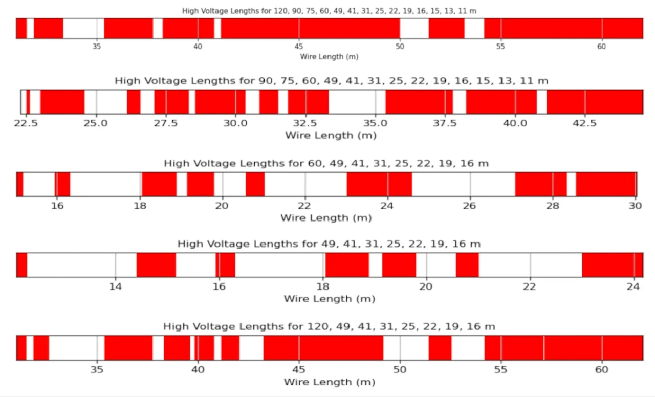

There is a endfed calculator in python for ham bands on End-fed Antenna Lengths
I modified it for shortwave bands. See attachment.
It never calculated full wave antennas properly in the original script so don't expect the [-f] option to work. I do not know how to code.
some example outputs. Red areas are to be avoided for random wire antennas.
In my area I only pick up between 49m to 16m. My ideal length is the center of large gaps (4th graph).
13m, 17m and 22m would be ideal for a 49m band to 16m band random wire (non-resonant) end-fed antenna.
