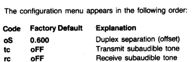

I am looking for the setup to change the offset from the stranded .600 to 4.00 I think that is correct for the CAP repeater on 148.15mhz with a muines offset of 4.00 sumething down in the 144.xx mhz area. Also the offset for the 146.64 repeater is set wrong in the 202. the offset is spouse 146.04 input to the repeater The HTX-202 is showing 145.64 with the offset set to (-). How do I change the off set.

page 26.
I gave the manual a 3 second read and that jumped out, maybe a more concerted effort would also unlock some other secrets?
