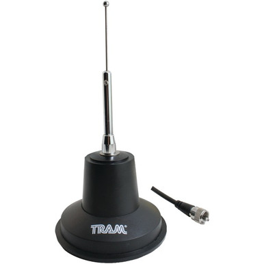

I finally had the opportunity to do some real world testing with my equipment. I got my Tram 3500 antenna yesterday, so I put that onto my truck. Today, I put my old Radio Shack mag mount antenna onto my younger daughter's car and hooked up my TRC-502 to it. I had her sit in her car in our driveway while I drove around to various places in our community. I showed her how to adjust the squelch and off I went. Our area has undulating terrain with LOTS of trees. We were able to hear and talk to each other out to about 4.8 miles apart. Both CBs are stock, nothing special done to them. I stopped at a number of friends' driveways and was pleased to hear that if they also took an interest, that we could easily chat with them from our house to theirs. We conducted this test for approximately an hour and a half, all on channel 20. I never heard anyone else talking the entire time we were doing this. I should mention, the Radio Shack antenna is only 34 inches tall. I have another one of those, but I have to get another ferrule for it before it's ready for service.

That Tram 3500 is designed much like the Wilson 1000M. The base load is a tuned circuit with a DC ground so it helps reduce noise a lot.'
The Sirio 5000 on the otherhand is just a base loaded whip and more susceptable to noise. Design much like the K-40.
Technically 5/8 wave, they all have about 3.2 Db gain.
Most base loaded 34 inch antennae I have seen are like the vintage Antenna Specialist M-125. Design like the Tram and Wison.
The difference is they are 1/2 wave and provide about 2.5 Db gain.
All very worthy antennas pending your noise environment.
About magnet mount. Some have claimed they detract from performance or induce SWR problems, and that is not true.
At 27 Mhz, the capacitive coupling to a roof compares to a short. Capacitice reactance near zero ohms.

I read a lot of reviews and watched people getting really good range on youtube video's with the Tram 3500. I bought one to try and love it! I had a K-40 magnet mount from 1989 that worked good in 1989...... but didn't seem to work too well last year ....so I bought a new one in July 2023.. I think the tram 3500 worked about the same.... the Tram 3500 was nice and springy and bent to go under my garage door a lot easier.....
using the Tram 3500 and an old President Grant cb (12 watts AM 27 SSB) on AM I can quite regularly talk a couple towns away .... many times in the evening 20 plus miles on AM.......and on SSB I can generally get 30 to 50 miles ( mostly talking to base stations) and it does skip all over the country.. I'm sure their are better antenna's.. but I really like that Tram 3500.....
it didn't do overly great when I first put it on, but I think I was testing it in the daytime with terrible conditions I only got 3 or 3.5 miles...... this was before I did a lot of RF bonding on my Pick-up truck ( thanks to the suggestions of some great guys on this forum)
I can't swear to it that it made a difference but I almost always get a trucker answering my radio checks ( 5 to 10 miles away) after I did the RF bonding.... and I can always hear people talking far off.... before the RF bonding I never heard a sole.... but right now I wouldn't change my Tram 3500 for anything ...even though someday I hope to try that Stryker AR-10....
I bought another Quad 5 for the pick-up but that old president is kicking butt so the Quad 5 has been sitting in the box for a few months now
.......... I plan to do a youtube video on the range I get with the President and Tram 3500 before I swap it out I'll do what this guy does and see what I get..... I asked this guy how he picked his route and he said he just drove... over hills..... through towns...... and forests under bridges.... some spots were low in a valley and some were high up on a hill.... but he just stopped every mile and did the test.... he got 18 miles with it on the trunk using only 4 watts.... it will be interesting what I get

I chat with him from time to time.... the 18 mile tram 3500 video is 6 years old and he say's it still going strong!.. but he tried the new Stryker AR 10 last year and it was much better than his Tram... so now he has me wondering if i should try something new.
my Tram 3500 is a cheap antenna. and I don't think it will last for years and years .... but I bought 4 of them!!! some I got for $41 bucks with free shipping
the last one i bought I got it for $31 and free shipping!!!! it came in three days too!

FYI I understand Tram no longer makes the Tram 3500 and did away with them last year.... they sold what they had to discount houses all over the place that are selling them for practically nothing.... I know that Wilson K-40 and Tram are now all owned by the same company??? and the Wilson 1000 K-40 and Tram 3500 were all using the same basic technology so I can see the parent company getting rid of one of them.... going to be sad when I can't get a replacement tram 3500 someday.
