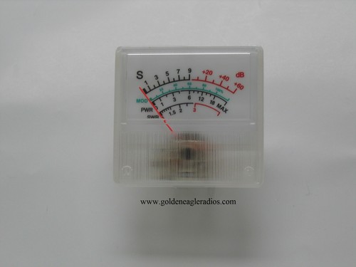

I once owned the DX 302 years back - Ill say if its running no need to change the capacitors out yet - the meter could possibly be replaced
with a Cb radio equivelent like the Galaxy Saturn Meter
