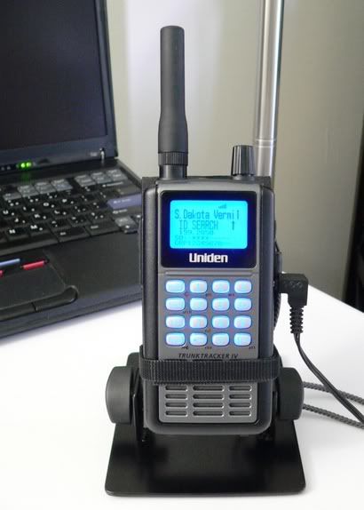

I just got the Maldol MH-255 SMA "Active Hunter" in today. It is a very flexible ducky; size-wise, it fits the 396T extremely well and is exactly HALF the length of the stock Uniden ducky. There are no markings on the MH-255, so it would probably be difficult to tell the difference between it & it's 2M/70cm sibling, the MH-209 SMA.
So far I am very pleased. It picks up all the local 159MHz VHF P25 traffic with a full five bars (to be expected since tower is rather close). There hasn't been enough conventional traffic on the distant site I was trying to compare, but will update when I get a chance.

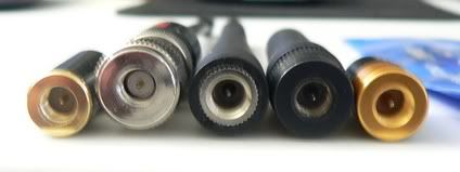

(from left to right: Pryme RD-9-SMA, Radio Shack 800MHz BNC w/SMA adapter, Uniden 396T stock SMA, Maldol MH-255 SMA, Maldol AS-25 SMA)
