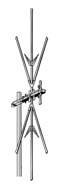

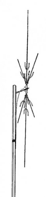

Many people, including myself, have confused the two antennas, at first glance they appear the same. The easiest way to tell the difference is by looking at the UHF elements connected to the main elements: The ST-2 has 2 sets of triangular/pointed ones, only on the center elements. The CH 5094-A series have 6 U-shaped ones, one on each of the 6 main elements. (See illustrations below)
AntennaCraft ST-2:
ChannelMaster Montenna 5094-A:
Other than these small elements the antennas share many common design elements, they each have a center boom to which a pair of long vertical main elements attach and act as the feed points. Attached to the main element an inch or so from the boom at a pair of smaller elements at roughly 45-degree angles from the vertical main elements. Both use 300-75-ohm baluns to allow the use of coaxial cable to connect to the scanner. They would come with a 50-foot length of 75-ohm RG59 cable. An adapter would then be needed to connect to the scanner, later units came with an F-BNC adapter, I don’t know if older units came with an F-Motorola adapter or not.
