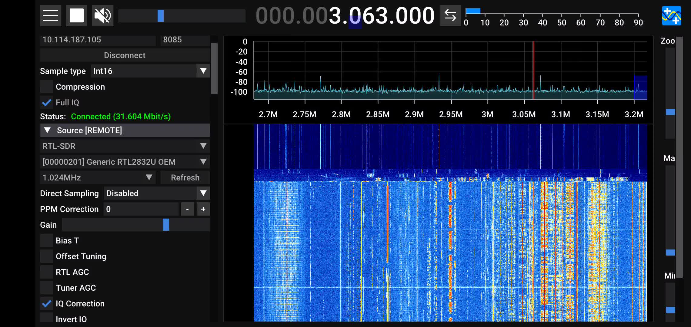

I just tried spyserver, with the blog 4 I could only get it to work above 24 mhz, i didn't check how high it would go "derp"

What is spyserver and how does it work?
thewraith2008
Nov 22, 2016
1,890
For the Spyserver option, you can configure 'spyserver.config' (using notepad) so it doesn't list/announce the setup as publicly available.
# List Server in Airspy Directory
list_in_directory = 0
