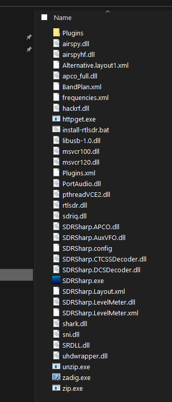

One of my sdrsharp directories and sdrsharp latest version running.
Files stored exactly as they have been for several years.
the scanner logs and recordings are saved to sub-directories to keep things tidy.
So....same files...same locations...working fine.
