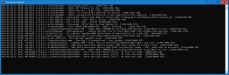

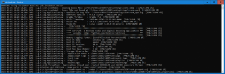

Hello. I have tried different options and I'm lost. I am running SDRTrunk v0.6.0-alpha 5 through a RSPdx. The software appears to be reading my RSPdx but I am not getting any audio. I have looked at my messages in SDRTrunk and it says "sync loss". My RSPdx is enabled but the channels are locked and my status is IDLE. Is it the software or hardware or, better yet, the user because I don't have a clue.

Please post your startup log.

Sorry for being late. I have screenshot all of my settings.

Now post your Channels tab from the Playlist Editor. Note that I can recreate the error message "Error starting channel [xxxx] No Tuner Available" by attempting to start another Channel that is out of bandwidth of the current Channel that is being played. Make sure to only run one channel at a time if they are in different bands or separated by more than ~ 2 MHz in your case.
