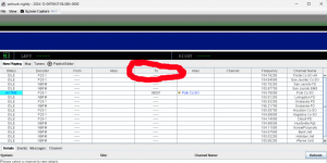

I could use some help with my SDRTrunk setup. I have an approved feed for a conventional P25 Phase1 system, non-trunked. When I try to stream it via Broadcastify, I cannot hear any audio.
In SDRTrunk, it recognizes my approved feed but does not hear any audio. I am confused about whether I need to select an alias to actually pick the channel to stream. When I try to do this, all I see are the trunked channels, and I cannot see the conventional channel.
Any help would be great. See attached for screenshots.

A conventional Phase 1 P25 system, non trunked? Hmm. Sounds like a single P25 repeater, no system. You need to add any talkgroups used on that conventional P25 frequency to an alias list. Then under the streaming setup, under the Alias section you have to move those talkgroups from that alias list from the left panel to the right panel.
No talkgroups being streamed means nothing being heard on the feed.

Thanks for the info but there are no 'talkgroups' as it is not a trunked system, just conventional P25 repeated system. That I believe is why I am not seeing any of the channels under the alias. I cannot figure out how to add the regular conventional system to be able to be attached to the feed so it will stream.

Each conventional system, whether NBFM or P25, needs it's own Alias list. After setting up the channel, you need to monitor the "TO" column to see what the "Identifier" is for the channel.
Then when you set up your Alias list, you enter that number from the TO column as the Identifier. Most of the time it is a 1, but can be any number as designated when the system was setup.
Then add it to your streaming list.

Thanks. I see it transmitting on the now playing tab when I transmit, but cannot for the live of me figure out how to assign an alias so I can link it to the streaming tab so it will broadcast remotely.

Now Playing - Click on the P25 channel, then down below click on Events. Look for a talkgroup -- a TO:
Whatever the talkgroup is, you add it to an alias list that you create in the playlist editor.
Then in the streaming config you select that alias list and move that talkgroup from the left pane to the right
A screenshot of your Now playing --> Events informatoin for that channel would be most useful. Otherwise, you are making us all guess. You are the one that has everything in front of you.
