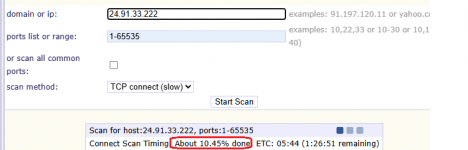

May want to try tools like this:
I see port 8443 open. I believe when it's open, it's in use so you may get an error in ProScan when starting the server on port 8443, stating the port is in use.
My point is that your IP address is reachable and not all ports are blocked.
My point is that the IP address is reachable and not all ports are blocked.
Wow I, like Enforcer52, have not been able to find any open ports on my own address with port checker. I will try 8443 now!

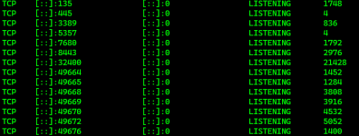

Everything working fine on port 8443 locally. I wonder if another process on the network is using this port? Is that why I can't connect from WAN?
bostonkid
Aug 13, 2008
25
3
So I ran a PowerShell query of open/listening ports - 8443 is here as well as several others that will most likely come up in your search - I looked up the the PID (process IDs) from the far right column in Task Manager that correspond to the ports open, they often show various windows service-host processes other other administrative system tasks as the owners.
Perhaps start the web server with port 5000, or any port then see if it shows here. I don't know how valid of a test that would be but maybe another clue.
