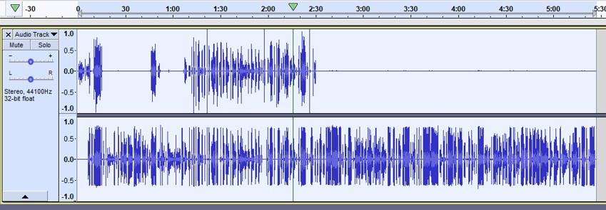

Ok, Fort Worth Regional Radio System Layer 1 is very boring (at least from 7-8 AM). I suspect most of the traffic, here, is encrypted, as in 1h17m of recording, only 5m of audio captured. Route was from Kennedale, across on I20 to 360, up 360 to 183 (20 minute pause at Starbucks at Trinity/360), 183 to 161 to Belt Line to the office on Gateway.
What audio was received was heavily in favor of the SDS100. The middle section where both were working was around the 360/Trinity area.
Pic of compressed

Listening to it, now, there are some blips and bloops where decoding wasn't perfect on the SDS100. But, keep in mind that the signal was so bad the 436 decoded absolutely nothing.
Overall the SDS audio is superb. Any idea as to what those blips and bloops might be attributable to? Really bad simulcast distortion, other types of RF interference, etc? If I understand the technology right, the I/Q demodulator should address all simulcast issues, but some imperfections might still arise from other interference. Is this understanding correct?

It is, you can even have that happen on a system radio
