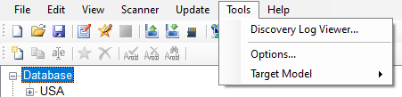

If you did not write to the scanner, reading the scanner should retrieve your settings. If that works, I would suggest, since everything you want is in the scanner, verify the folder location in Sentinel in the Tools tab. If its pointing to Onedrive, change it to where it should be or reinstall Sentinel. Then read the scanner again.
