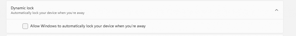

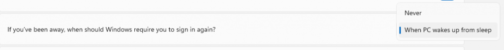

Settings ---> Accounts ---> Sign-in options....
Set the option choice in this box:

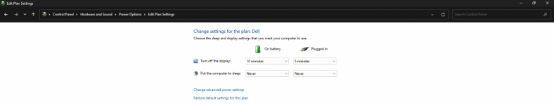

Also, double check the screen saver settings, and here:

✅ Solution: Disable Password on Wake from Display Off
Open Settings:
Press Windows + I.
Go to: Accounts → Sign-in options.
Look for: "Require sign-in".
It’s usually under the "Additional settings" section.
Set it to: Never or "When PC wakes up from sleep" → Never.
⚠️ If it says "Every time" or "When PC wakes from sleep", that's what's causing the issue.
Also check power settings:
Open Control Panel → Power Options.
Next to your selected plan, click Change plan settings.
Click Change advanced power settings.
Expand Display → Console lock display off timeout.
Set this to 0 or a long duration.
