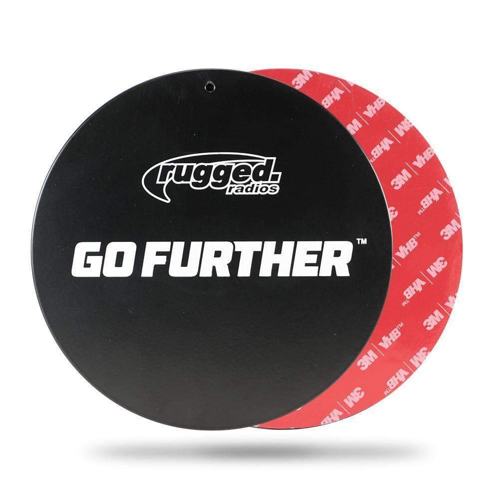

I did not know that this product existed, but I'm not surprised that it does:
Someone asked about this in a Ford Expedition forum (Expeditions since 2018 model year have aluminum bodies). The poster noticed this disk stuck to the roof of his Expedition and didn't know what it was.

This is a photo of one of these disks stuck to the roof of a 2020 Ford Expedition with unknown miles:
1000000063-jpg.85072
26,578
If that's the 3M VHB stuff, and the surface is well prepped, it's probably fine for a small mag mount antenna.
As for mounting on a fiberglass roof, 5.5" isn't much of a ground plane, barely enough for 800MHz. No where suitable for UHF, VHF or CB on a non-metallic roof.
I get that some don't want to drill holes, but I'm always surprised at the lengths people will go to. This still has the drawbacks of a mag mount with the added complication of that VHB probably being very difficult to remove from the vehicle if needed.
