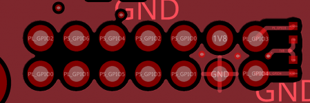

The top layer of the Pluto PCB can be seen here:
The 14-pin connector shown in the lower right corner of the PCB is used by the v0.39 firmware to communicate with hardware connected to the Pluto. Analog Devices provides a complete schematic with the Cadence Allego PCB project file. The 14-pin connector is defined in the Pluto Rev-D schematic and Allego PCB project file as follows:
You will quickly notice that the GPIO pins are both PS and PL types. The PS GPIOs are General Purpose Input/Output pins connected to the Zynq 7010 Processing System (PS), which is the embedded ARM processor. This allows for control and monitoring within the Linux operating system, while PL GPIOs are connected to the Programmable Logic (PL), the FPGA fabric, enabling hardware-level control and status signaling through custom HDL (VHDL/Verilog) designs. The key difference is their hardware domain: PS GPIOs interact with the software environment, whereas PL GPIOs are integrated into the parallel hardware fabric of the FPGA.

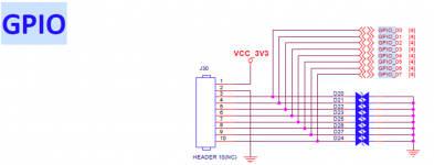

The ANTSDR E200 PCB does not have a 14-pin connector, but instead uses two rows of connection points on the lower edge of the PCB. The silkscreen identifies the six (6) connection points on the lower left edge of the PCB, but the silkscreen does not identify the ten (10) connection points on the lower center edge of the PCB.
The documentation available from MicroPhase for the ANTSDR E200 is very limited. They provide a partial schematic for the PCB, but they do not provide an Allegro, OrCAD, or KiCad PCB project file, so it is impossible to know the exact signals provided to the sixteen (16) connections points on the lower edge of the PCB. The only information provided in the ANTSDR E200 can be seen here:
Does anyone have sufficient information for the ANTSDR E200 to map the 14-pins on the Pluto onto the ANTSDR E200 PCB? If so, could you provide me with this missing information? Can you also share the ANTSDR E200 documentation that you used to obtain this information?
