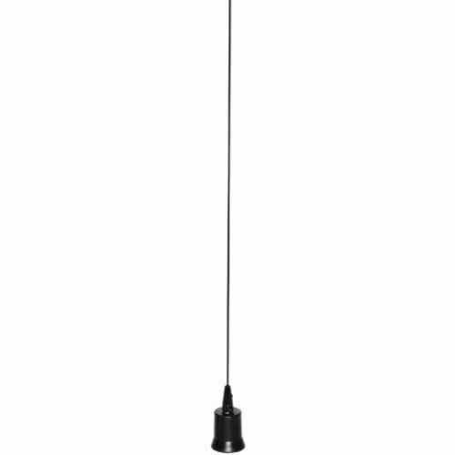

I recently bought a Traintenna mobile antenna (Link) to monitor the rail band (160-161 MHz) that I mostly use at home.

Avoid a preamp, especially indoors. Try to get the antenna outside on the roof, height is your best friend and even getting it just outside a window is much better than indoors with a preamp. You can buy or make a base station adapter for the Traintenna that has ground radials, and that antenna needs a ground plane. Or you could buy essentially the same antenna for about $27 shipped and get the base station adapter for about $29 shipped and you will still have the Traintenna for mobile use.

I've actually kept my old tram 1094 for mobile use, it works pretty nicely on the car.
I'm not quite sure about taking my antenna outdoor yet, it has actually worked pretty well so far. I have it all the way up in my cupola at the top of my house, however up to this point I've been using a old metal box as a ground plane. Would the mounting kit still improve my range, even if I kept it indoors?

Your best bet is to mount an antenna outdoors, and with what you have already I wouldn't spend any more money on antennas. If you want a simpler ground plane then get the ground plane kit that prcguy posted and use it with the Traintenna at home and use the Tram in your car. I seriously doubt any "indoor" antenna will work better than that, they are mostly designed to "blend in" with an indoor environment and look nice, not really perform any better.
