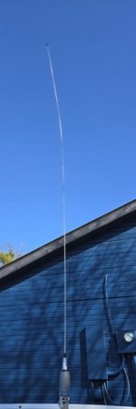

Just got a Sirio Performer 5000 (w/o green light👍) put on the car for comparison against the Stryker SR-A10 on the G90. SW reception was already good, but hopefully the extra length will help a bit there. SWR < 2:1 from 25.800 to 27.660; good enough as is with the internal tuner. Will report back.

But can it reach Parker County?
No.
It can't even reach Ellis County.
This week, I've compared the Sirio Performer 5000, a Wilson Lil Wil, and the Stryker SAR-10. Both on the car and the metal roof, the Stryker was a clear winner over the Sirio and Wilson, which were about equal. Radios were a Xiegu G90 and QT-60Pro, on skip and local traffic.
Weak SSB signals easily heard on the Stryker were gone on the other two; most noticeable was the complete disappearance of those faint voices in the distance that you can hear on an NRC radio.
Broadcast SW reception was similar on the Stryker and the Sirio; the Wilson markedly worse.
I was unimpressed with the quality of the Sirio antenna; the castings and machining are not great(or even good). Strangely, the Sirio makes more wind noise than the Stryker.
All they guys around here love their Sirio 5000s. They were surprised at the difference the Stryker made in my signal, 1-2 s-units on their RX.
Twice the price, twice the size, and about the same performance as the Lil Wil. What's not to love about the Sirio? 🤣

...also when I hit something it bent and stayed bent??? I could manually straighten it ..... but most antennas don't easily bend like the Sirio 5000 did.....
This is from hitting 90 mph on I-45 this morning. No impact, just wind.
What a piece of garbage. Sirio just lost some other sales from this junk; I'm about to put up some base antennas and had my eye on a few Sirio models, but they just got kicked off the list.
Seriously, even Chinese Shinola is better quality!🤣🤣🤣

That’s a bummer. Maybe you ended up with a “Shirio” Chinese knock-off from a shoddy Amazon seller? I don’t own any of their mobile antennas, but i ordered my base antenna direct from Sirio in Italy. No issues with it yet, and it’s made it through some pretty brutal WI tornado season and winter blizzard winds. Still straight as an arrow.
EAFrizzle
Bond. Ward Bond
Jun 2, 2019
1,063
1,465
SE de DFW
I got the scratch-off/shiny thingy code to the Sirio Italian website, and it says it's real. Same with the mag mount.
I do have to say that the Sirio mag mount itself is very good; I'll probably leave it on the car and slap the Stryker on it.

yup I was shocked the antenna material was like that of a coat hanger... you could hand bend it to any shape you wanted ... not the stainless steel springy material I'm used too .... but they must have had a reason for making it that way??? I just assumed that, .... that material must receive and transmit better than the other antennas on the market.... I wasn't complaining about it..... but I was very surprised.... again it did work really good.. just not worth the extra money and extra height.
mrweather
1,356
365
That's weird that it would bend that far up the whip and not at the ferule base.
I guess coat hanger steel is cheaper than spring steel.
