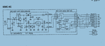

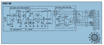

Last week I ordered a RMC-9C desk mic to rewire for my TK-790H since the RMC-9B are like finding gold bullion.
When I rewired it and tested, I got “low audio” reports and some reports of a “buzzing” when transmitting.
I ordered a new mic to try and rule out and now I have a full 110w carrier but no modulation whatsoever.
Tried 2 seperate Kenwood OEM Mic heads and an Amazon knockoff head. All were the same.
Have I just trashed my radio and turned it into a scanner!? 😂
Open to ideas.

You mean KMC-9C, right? Is there 13.8V on the SB (switched B+) pin 1 at the top of the round mic connector on the radio when it's on? Did the stock KMC-27B or C mobile mic work?

Hmmm. That radio is before (and after) my time, so I'm not directly familiar with it, but burnout of SB to the mic connector is a common problem across Kenwood models. The KMC-27B looks like a straight dynamic mic, and so would work without that SB. The -27/27A have noise cancelling that needs it, and the -9/9B/9C are all amplified and so would need it.

Now that no mic works it makes me wander if power from pin 1 was put back into the radio on the audio circuit?
It very well could have been. Me being dumb, I didn’t look up the pinouts when trying to make the adaptor cable, I just tried to match up the tiny wires. 😬😂
