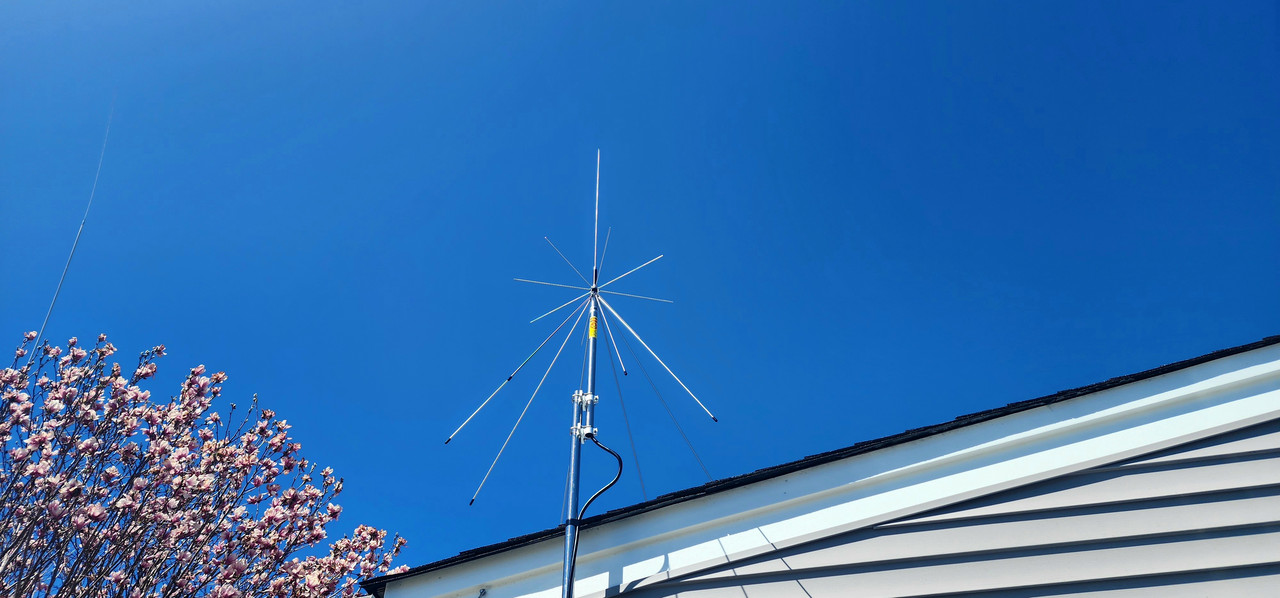

Excellent choice. Love mine and I'm sure you will too.
