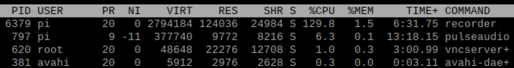

Hello all,
I have successfully gotten Trunk-recorder on a Raspberry Pi 4 to work with a single Airspy mini SDR. Now, I am attempting to run two at the same time to monitor a site with frequencies that exceed the bandwidth of a single SDR. Everything works well with a single SDR (apart from some traffic getting missed), but when I add a second SDR to the mix, it seems that no traffic is being received while monitoring the exact same site.
Here is my basic config.json file for testing:
JSON:
    "ver": 2,
    "sources": [{
        "center": 853000000.0,
        "rate": 6000000,
        "error": -167,
        "lnaGain": 15,
                "mixGain": 7,
                "ifGain": 7,
        "digitalLevels": 4,
        "digitalRecorders": 5,
        "driver": "osmosdr",
        "device": "airspy=0x10A862DC351E2463"
        "center": 858000000.0,
        "rate": 6000000,
        "error": -300,
        "lnaGain": 15,
                "mixGain": 7,
                "ifGain": 7,
        "digitalLevels": 4,
        "device": "airspy=0x10A862DC346A2263"
    "systems": [{
        "control_channels": [859787500],
        "type": "p25",
        "shortName": "VIPER CLEM",
        "modulation": "qpsk"
It seems that both SDRs are opened correctly, and I do not get any initial error messages, as can be seen in the following excerpt from the log file. However, after the software attempts to start recording traffic, it acts as though it is not receiving control channel data. Does anyone have any suggestions? I am new to Trunk-recorder, so it is highly likely I am overlooking something simple. Any help would be much appreciated!

Just to add a little additional information:
My first thought was that adding a second SDR meant that there were simply too many resources being used. So, to check this, I noted that when a single SDR is used at a 6 MHz bandwidth, the process uses about 150% CPU usage and behaves normally. I then modified the above JSON file so that each SDR was operating at only 3 MHz bandwidth since 6 MHz was a bit overkill. Given that configuration, the CPU usage was about 130% (slightly lower than when a single SDR was used at 6 MHz).

Well, I believe I found the issue:
The good news is that even the previous image version does actually support multiple Airspy SDRs. The bad news is that it seems that the Raspberry Pi 4B simply cannot handle 2 Airspys at 6 MHz. However, it does seem to work with 3 Airspys (two at 3 MHz and one at 6 MHz), interestingly enough.
I also discovered that when operating at 3 MHz, your actual usable bandwidth is only about 2.4 MHz, and it just so happened that my control channel fell just above this cutoff. After making some adjustments, I am now receiving traffic error-free.

My experience with any PI (even up to the latest) is that they simply don't have the guts to run OP25 and monitor a lot of bandwidth without CPU starvation. I finally gave up on them. I've tried some various other ones too, like the Rock devices and they suffer a similar fate. They just don't have the juice for serious work.
