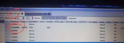

Higher PL tone, different MURS frequency. Still no dice.

Uploading the same CHIRP image to different radios that don't have the exact same firmware can cause problems.
all radios are identical. (If you were talking to me)

Right. The test radio is set that way to act as the "outsider radio." I know it will be able to hear any of the other radios. I want the other 2 radios not to hear the test radio. Sorry if I wasn't clear on that previously.
The advice you've been getting thus far is spot on, which leads to the conclusion that either the radios are faulty, or the CHIRP software is not doing something right. Here are two other suggestions...
1) Try using DCS rather than PL tones;
2) Try activating (or confirming) the privacy feature (either PL or DCS) directly on the radio, effectively bypassing the CHIRP software.

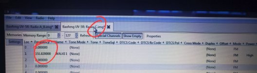

Here are the different modes I have tried. Please note this image doesn't show, but I also tried Cross mode.
There are only two channels programmed in that, that could possibly work. 1&3. You don't have a receive tone on the other two. 1&3 are the same so not gonna be much different there. Have you even tried another frequency just to check?
Yes, I have tried the frequency for MURS 1 and MURS 4 (Blue).
I have updated CHIRP and acquired a new programming cable too.
