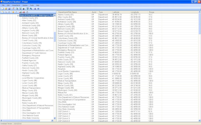

The Ohio MARCS system works very well with it but you do have to avoid out a lot you don't need as it loads the complete marcs system and will spend extra time scanning that system. I am hoping when I use the GPS with it using a 10 mile range may help.
I cannot find MARCS in the database. Did you have to add it?
KE4ZNR
Radio Geek
Jan 21, 2002
7,299
In any Ohio county look under "statewide" and you will find this:
Happy Monitoring
Marshall KE4ZNR
