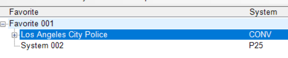

Go Into the Favorites Editor. Click on a system node on the left side, then click the Unit IDs tab on the right side. Now you can enter in the text tags.
Unless I've done something wrong within Sentinel, the Unit IDs tab does not show up for conventional systems.

Yeah that certainly seems to be the case. I'm just confused as to why Sentinel will allow Unit ID Name as a field within the Conventional display settings :unsure:

Me too. Conv. systems spits out UID's. I'll have to look at my program and see if the Unit ID tab can be enabled on conv. systems

I am pretty sure because if you have any convention digital freqs programmed in as One Freq Trunk, you would be able to see the uid on the conventional screen.

Conv. P25 systems shows the UIDs on the scanner display. I'm logging them now.

I just confirmed on my scanner that the 1 Freq Trunk systems I have utilize the "Detail Trunk" display settings and not the "Detail Conventional" display settings. So I'm still not clear on why "Detail Conventional" allows you to select Unit ID Name for some fields.

So you have a p25 freq programmed in a conventional list, not programed in as p25 One Freq Trunk and your getting the uids?

Yup that's what I have as well. It knows what the unit ID is, but there doesn't seem to be a way to alpha tag it and show that tag.

Then in that case I believe it needs to be programmed in as One Freq Trunk so in the editor, alpha tags can be associated with the uid's (and the uid's can be stored) since in both Sentinel and Proscan, there is that option in the system options.

I never even considered storing a conventional P25 channel as a One Frequency Trunk. Wil give that a shot later. It's a bit of a non-starter for me as many of the agencies around me are P25 conventional and I'm not gonna save each one this way but for the most important ones it'll be nice to have.

Figured I'd come back and close this thread. As suggested above, I programmed the conventional P25 channel as a P25 One Frequency Trunk and the unit ID names are now displaying.
It seems that the Sentinel software is a bit misleading with respect to the Conventional screen options. It's not just Unit ID Name - Site Name and Site ID are both available as options for a conventional channel which I don't think make sense.
One thing worth calling out that I didn't pick up on at first is that the default talk group ID when programming conventional P25 systems this way is 1 in most cases. I did see some entries in these forums for a few others based on the vendor but 1 worked for me. Also worth noting that the SDS100 was displaying talk group ID 1 in conventional detail mode so I just missed it initially.
