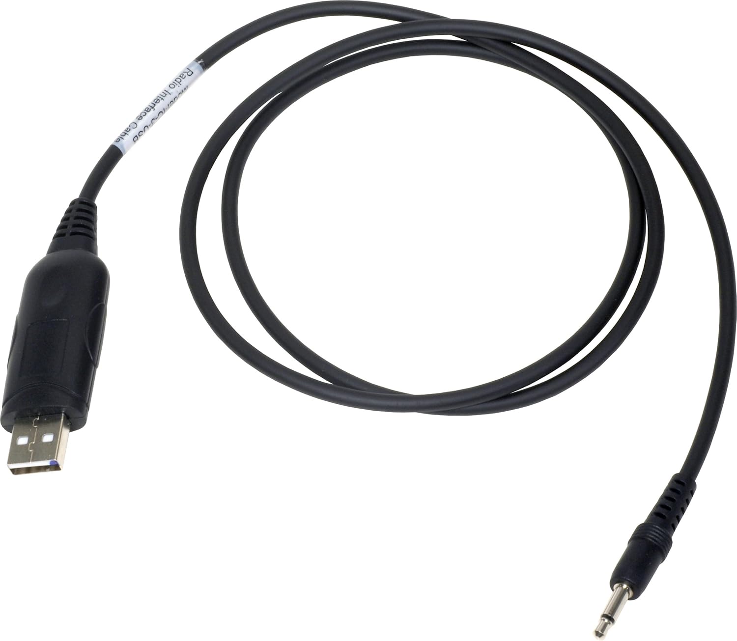

Has anyone deconstructed one of these? Its just a USB to male 3.5mm mono jack. A USB is 4 wires and a mono jack can only be 2 wires, so this shouldn't be a hard thing to figure out. I've done loads of USB hacks in my day, so this should be fiarly simple. If no one has done this yet the I will (unwillingly) spend the $20 and do the hack myself and let everyone know how its done.
Even though the IC-R10 has an actual CI-V socket on the side, programming is usually done through the Speaker Socket, which requires a Stereo 3.5 mm Plug, with the Data on the Ring.
Even the genuine Icom OPC-478 Serial cable was set up for the Speaker Socket.

If you have a Radioshack or GRE Scanner programming cable, you have a CI-V cable for Icom radios. Been using both the older model and the current model for several years very successfully.
