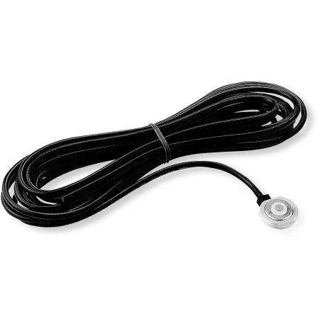

I'd also recommend doing a permanent install, as in actually drilling the hole in the roof and installing a proper NMO mount. It'll give you a bit of edge on performance compared to a mag mount, and will prevent damage to coaxial cable from getting pinched in doors or windows. It also looks a lot more professional and lower profile:
