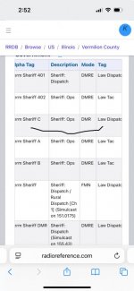

There is only one DMR frequency on the Vermilion county sheriff department. Sometimes I get 4 bars for signal strength. Are you saying the DMR the one I provided is also a DMRE as well? I did ride alongs with ISP and they mainly have STARCOM and they are all encrypted, but I did find the FMN on the troop 7 list. There were only 3. Thank you for the suggestion, I appreciate it.

There are multiple DMR listings for 154.755 and 151.0175. I don't know which is correct but I wouldn't trust any that show DMR non-encrypted or analog.
I've focused on county and Danville fire when I have driven thru since I can still hear those (DMR non encrypted).

On the website it shows 154.755 (DMR-Non encrypted) and 151.0175 is DMRE (encrypted). I clicked on the license for 154.755 and saw the other frequencies on there and added the ones with FB on it. I added the channels for FMN for Vermilion county Sheriff off department like Hoopeston, etc. I added the EMS on there as well. I, added the P25 listings for ISP for both East Lynn and Danville. I have full signal strength for both. I feel like the Uniden996P2 is easy to use and I don’t understand a lot of the comments on Amazon got bad reviews and some people paid other people to program it. Thanks again for the help. I am using my tv antenna plus signal booster and I am getting a lot of chatter now.

I haven't been up that way in years myself, but I caught them when they first moved to DMR. There was some encrypted, some not encrypted. Even some comms on the same frequency with different color codes. Months later than changed more and more and I think it all went encrypted, as far as I could tell. Then for a while, I didn't hear them on anything (I was monitoring for talkgroups and RIDs with DSD+) even though it was encrypted. Since this time, no one else has really been around there to tell us what is exactly going on. Just a little bit of info here and there.
With the drugs and crimes in that area, it's probably 100% encrypted. Just hasn't been confirmed lately.
I'm sorry you purchased a DMR scanner that can't be used to for what you want.
