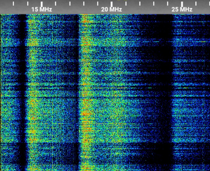

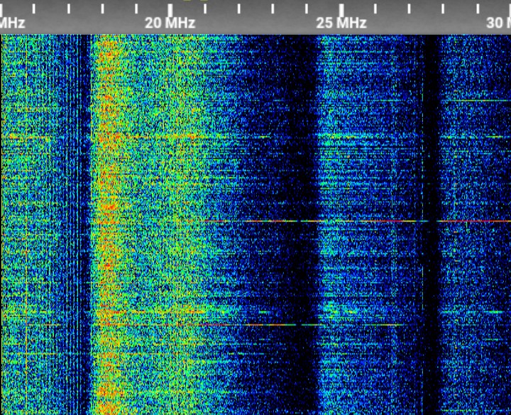

what causes this reception phenomenon?
wenzeslaus
Aug 30, 2023
149
64
a webSDR radio shows this on the waterfall display.
periodic frequency ranges of inconsistent width that are heavily biased at the lower end, about linear throughout most of the middle, fades out at the high end.
says the antenna is some model of DX Commander. must be a vertical antenna.
what causes this?

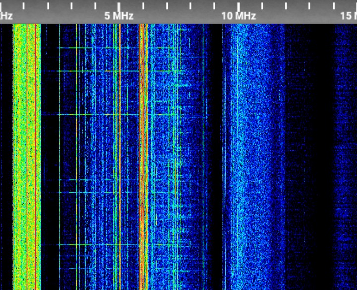

First, consider RF is some really strange stuff.
Your first display is nothing new, the strong signals down around 1 Mhz is AM broadcast.
The roll off getting to 15 Mhz is probably slow AGC gradually turning the gain down.
I can see 20 meters is a bit strong along with some short wave BC.
Boombox
Sep 2, 2012
1,538
531
Either seeing broadcast / ham activity, or it's RFI, or both. Some of it looks like it could be RFI.
